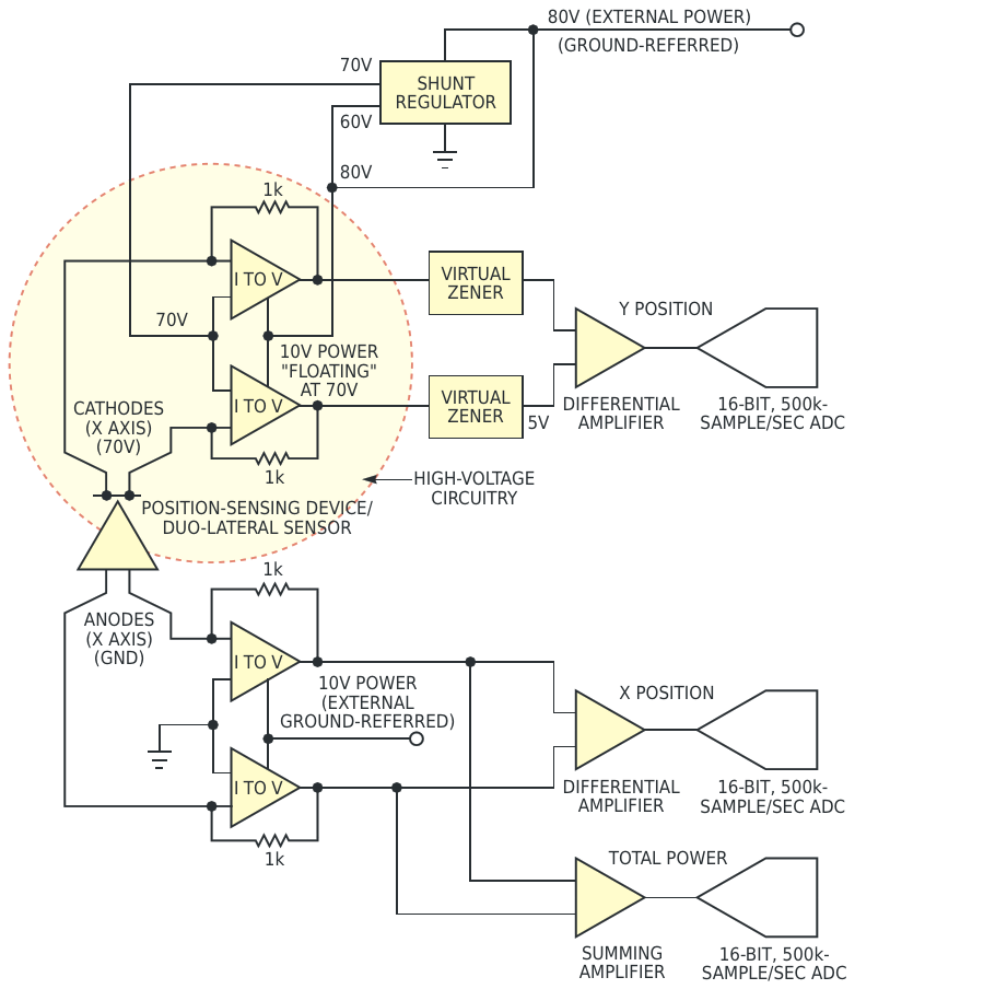

"Virtual-zener" circuits simplify the high-voltage interface in this position-sensing system

Figure 1. "Virtual-zener" circuits simplify the high-voltage interface in this position-sensing system
