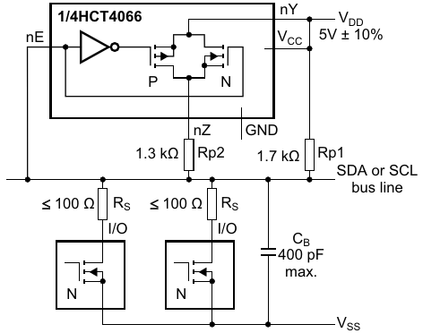

Switched-pullup circuit where the analog switch is activated at high bus voltages only, paralleling an additional resistor with the standard pullup

Figure 1. Switched-pullup circuit where the analog switch is activated at high bus voltages only, paralleling an additional resistor with the standard pullup
Figure 2. A schematic of simulated I
2
C drivers, pullup resistors and bus capacitances, without (old) and with (new) connection to the autonomous non-linear pullup circuit
Figure 3. A comparison of the performances of standard (old) and an enhanced (new) I
2
C bus signals. The signals CLR, CLK, and Q swing between ground and +3.3 V are shown scaled for clarity purposes
