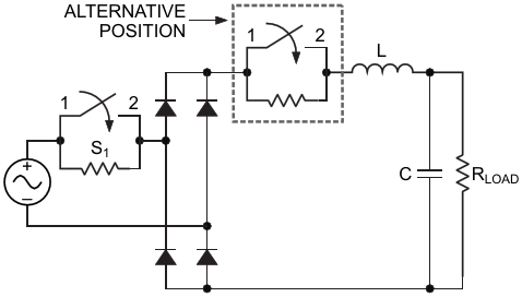

In this classic inrush-limiting circuit, the switch carries the full load current during normal operation

Passive circuit limits inrush current
Figure 1
Figure 1. In this classic inrush-limiting circuit, the switch carries the full load current during normal operation
Figure 2. In this inrush-limiting circuit, the current rating of the switch is considerably reduced
