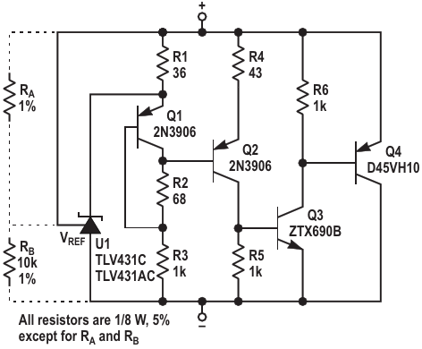

High-current, low-voltage shunt regulator
Figure 2
13 Kb
Figure 1. This high-current shunt-regulator is designed for applicationsrequiring shunt voltages ranging from 1.75 V to 6 V
Figure 2. When shunt voltages range from 1.24 V to 1.75 V, this circuit becomes a must
