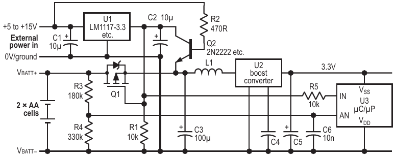

Pre-regulation of an external supply is combined with an almost lossless switch in series with the battery, which maximizes its life

Figure 1. Pre-regulation of an external supply is combined with an almost lossless switch in series with the battery, which maximizes its life
Figure 2. Using more recent designs of regulator means that Q2 is no longer necessary
