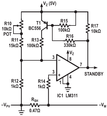

The comparator circuit with …
The comparator circuit with hysteresis generates the Standby signal

Figure 7. The comparator circuit with hysteresis generates the Standby signal
