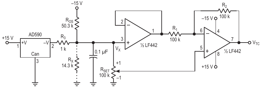

Almost any tempco, whether …
Almost any tempco, whether it be positive, negative, or zero, can be set with this inexpensive, simple circuit. For the values shown, the output is zero at 25°C and exhibits a tempco of between -10 and +10 mV/°C depending on the position of the wi
Michael Wyatt
Adjust tempco in size and sign
Figure 1
