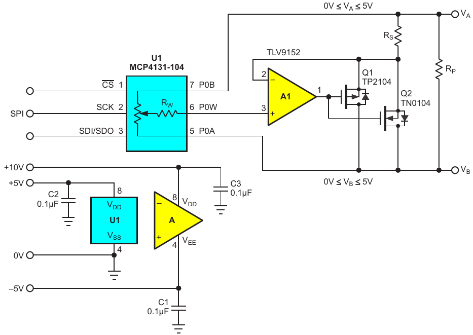

Synthesize precision bipolar Dpot rheostats
Figure 3
19 Kb
Figure 1. Classic adjustable resistance; R
MAX
= R
S
+ R
R
; R
MIN
= R
S
Figure 2. Synthetic Dpot evades problems by using FET shunt, precision fixed resistors, and op-amp
Figure 3. Simply paralleling complementary N and P channel MOSFETs might look good but won't work beyond a few hundred mV of |V
A
- V
B
Figure 4. Two complementary anti-series FET pairs connected in parallel allow bipolar operation
