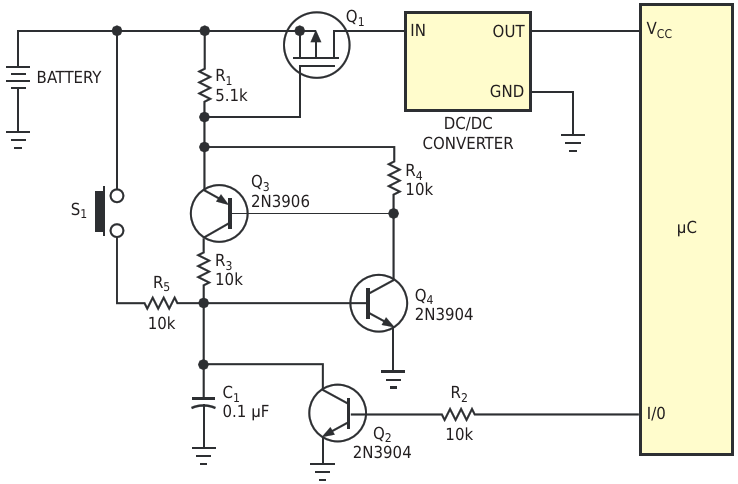

A two-transistor latch provides …
A two-transistor latch provides positive turn-on when you push the button
Eugene Palatnik
Transistor latch improves on/off circuitry
Figure 2
15 Kb
Figure 1. This on/off circuitry is effective but can suffer from turn-on ambiguity
Figure 2. A two-transistor latch provides positive turn-on when you push the button
