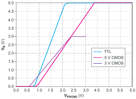

Simple logic probe uses bicolor LED
Figure 1. A simple handheld logic probe uses a rail-to-rail op amp and a bicolor LED (a). A modified probe circuit works with 3 V CMOS logic (b)
Figure 2. The output of IC
1B
, V
B
, limits at either the positive or negative supply rail depending on the probe voltage
