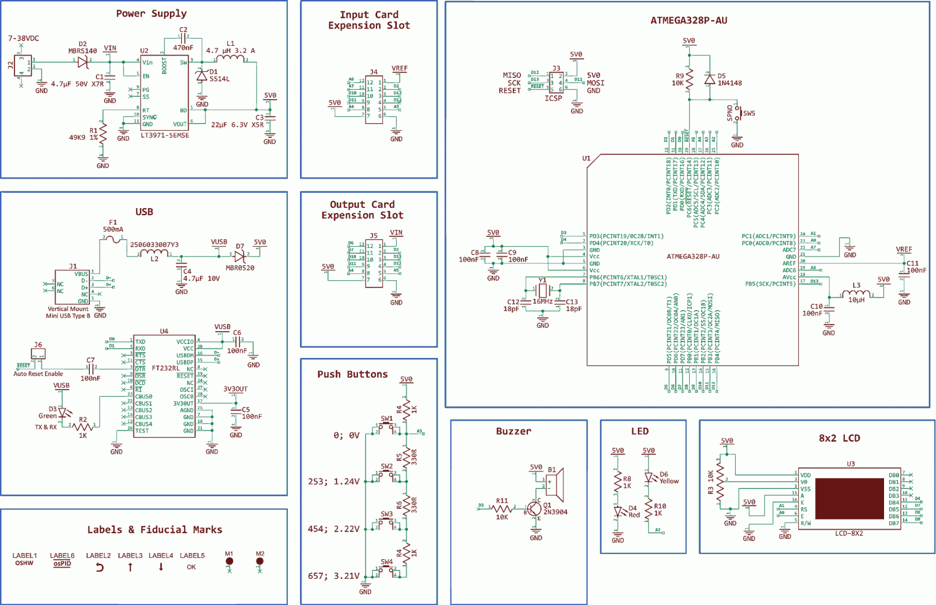

| Figure 3. | osPID Main Board Schematic. |
An efficient buck converter is used for power conversion, this allows the osPID to accept up to 38 V input power without overheating. Being able to accept this higher voltage also leaves the door open for voltage output applications such as ±10 V or ±5 V.
An on-board USB to serial converter chip is available for connecting to our PC-based user interface software. This allows for more advanced configuration without overloading the on-board UI. We also added the in-circuit system programming (ICSP) connector in case you wanted to modify the bootloader residing on the ATMega328P or simply wanted to run it bare metal without Arduino.
The main board is connected to the input & output cards through robust edge card connectors. We wanted the cost of the input & output cards to be as low as possible, as this is area most likely to be hacked by the end-user. By using these edge card connectors, no connectors are required on the input & output card side.
