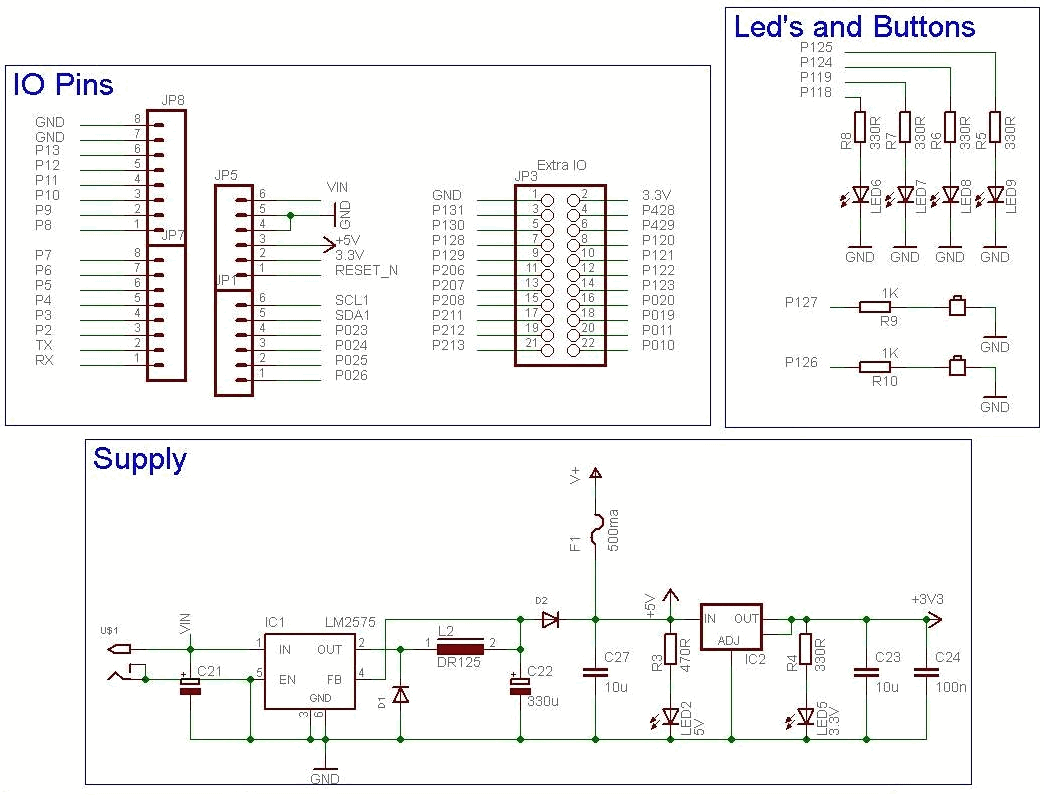

To keep the powersupply low-cost, NX1117 voltage regulators are used. The 3.3v supply is secured with a PTC (resettable fuse) of 500mA (Figure 2). The upper connector is the JTAG connector. It´s important to keep the pin-layout the same. This pin-layout is use by a lot of debuggers, for excample: J-link, U-link. Connectors JP1 – JP4 are exactly the same connected as the Simplecortex.
SimpleCortex Power Supply Schematic Diagram
Figure 2. SimpleCortex Power Supply Schematic Diagram

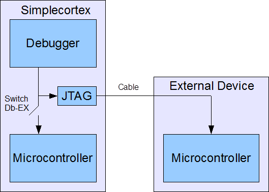

Programming external devices
With the JTAG header it is possible to program external devices. It is a cheaper to use a board with only microcontroller than using a complete Simplecortex in a project, once the project is finished no debugger is needed anymore (Figure 3, 4).
SimpleCortex: Programming external devices
Figure 3. SimpleCortex: Programming external devices

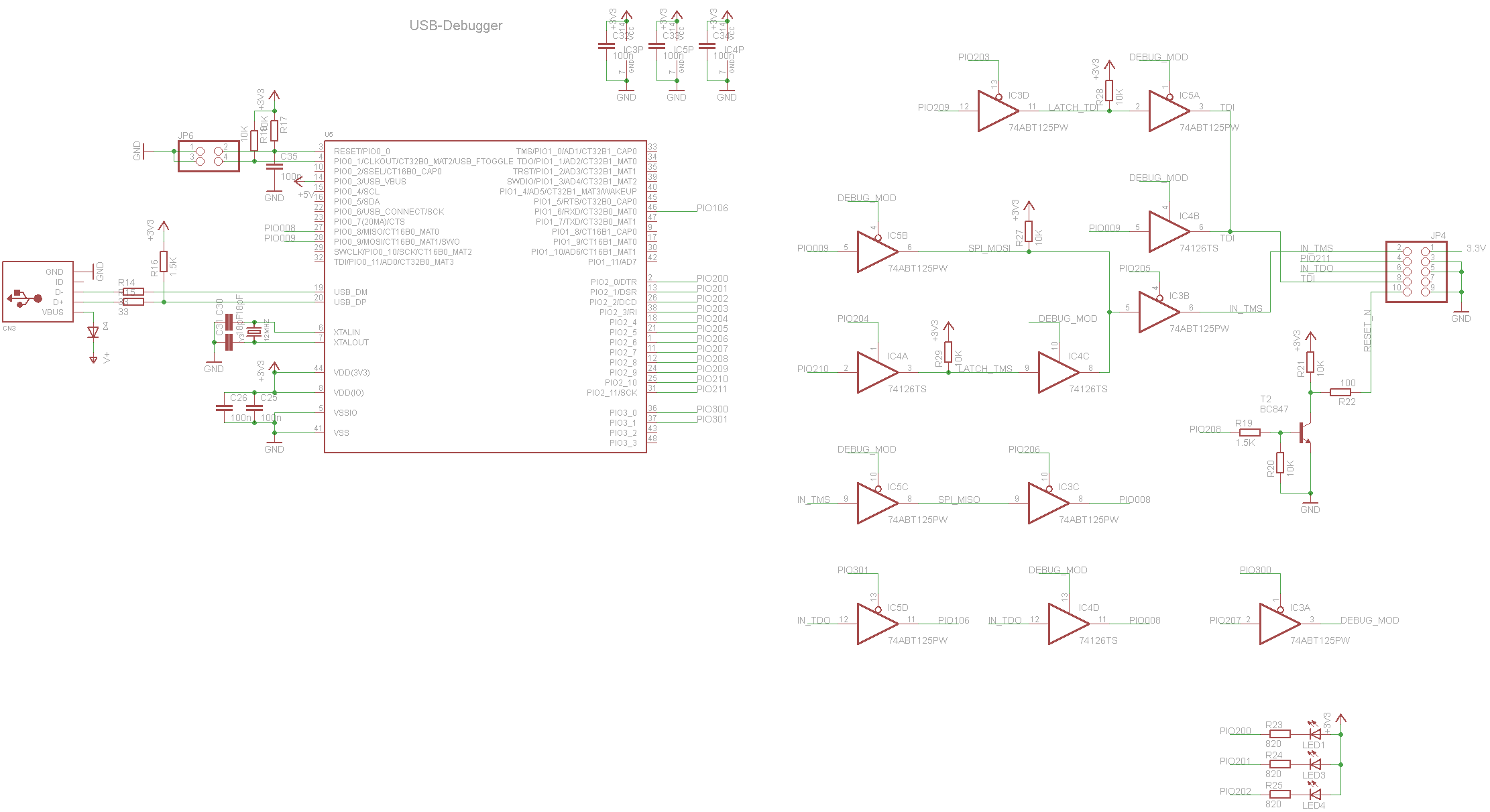

Before you can program an external device the microcontroller on the Simplecortex needs to switched off.On the Simplecortex there's the dip-switch B4 alias DB-EX (that is how it is called in the I/O list). Switch DB-EX (Debugger Extern) has a simple function, it only interrupts the supply of the microcontroller.
SimpleCortex Onboard debugger Schematic Diagram
Figure 4. SimpleCortex Onboard debugger Schematic Diagram
For this example we used a cheaper model of the LPC1769 (Figure 5). This microcontroller is also from the LPC17xx family but it has some limitations. To make your own project only the microcontroller, power supply and programming header are needed. All the unconnected I/O can be used although it is wise to check the datasheet first. Every pin with the discription Px[x] can be used as I/O. Most of the pins are internally connected to a periphcerals like I2C, SPE, etc. There are also 4 led’s and two buttons connected to the microcontroller. Obviously they can be removed but they are very handy for experimentation.
Принципиальная схема SimpleCortex: микроконтроллер и Ethernet
Figure 5. SimpleCortex Schematic Diagram: microcontroller, Ethernet, USB, microSD and User LED's and Buttons

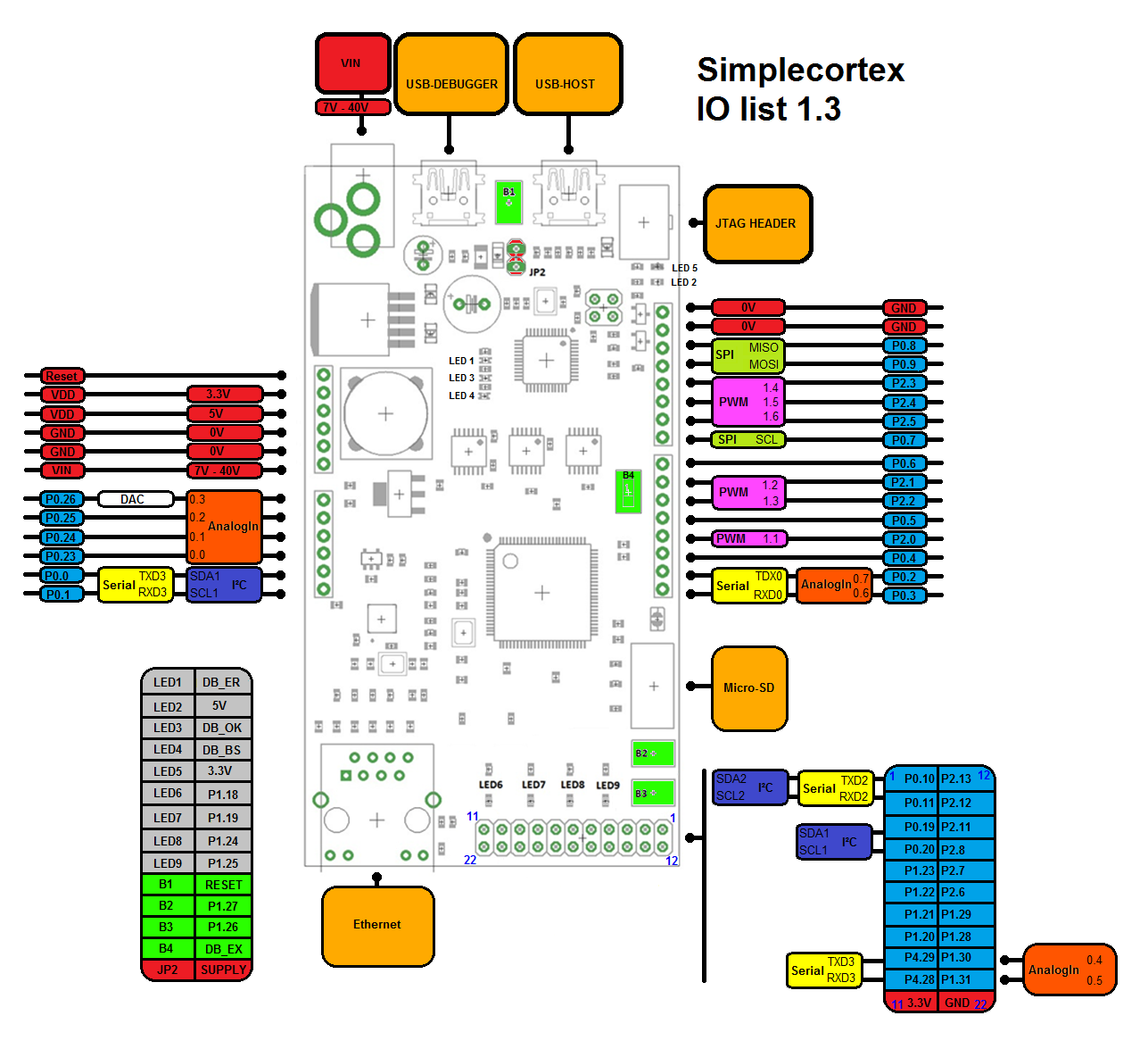

I/O List (Figure 6)
SimpleCortex I/O list
Figure 6. SimpleCortex I/O list
Definitions
  • HEADER JP2
The header JP2 is placed below the reset button and has an important function when using the USB-host port. If the USB port is used for serial communications, the USB will power the Simplecortex. If the USB port is used to read a USB which has no powersupply, place a jumper on JP2.
The Simplecortex has a diode for each USB ports to protect the pc from high voltages.
  • DB_ER
This is the debugger error led (red color) .
  • DB_OK
Debugger works correct and is connected with the pc.
  • DB_BS
This blue led will shine when the debugger is busy.
  • DB_EX
Debugging external devices. When the switch is turned off, the onboard microcontroller will not work. With this function it’s possible to program external devices via the JTAG header.
