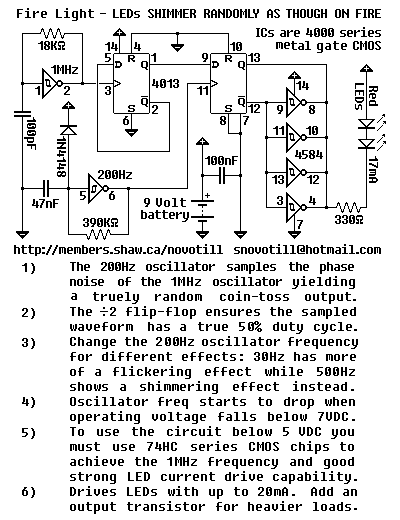

This may well be the world's only discreet logic circuit to generate truely random output. It makes an excellent candle flicker light for your haloween pumpkin, and looks much more authentic than a shimmer light wherever a good a simulated flame effect is required. I do not gaurantee the accuracy or safety of any information herein.
Fire Light - LED or Bulb flicker shimmer randomly like candle flame or fire
Circuit scheme Flickering Fire Light
