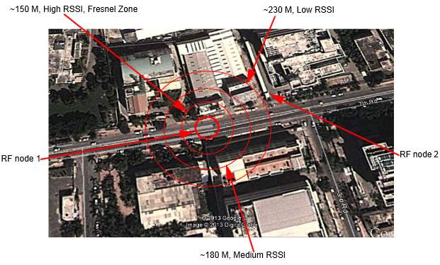

Location and distance for urban environment
