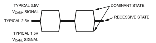

By using the signals on CANH and CANL wires, the CAN bus has two states: recessive and dominant (Figure 1). The bus is in the dominant state if the differential voltage is greater than 0.9 V and in the recessive state if it is less than 0.5 V. CAN transceivers, such as the ADM3051 , interface the CAN controller to the physical layer bus.

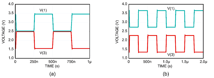

To avoid distorting the square wave output signals, C1 and C2 should be chosen as large as possible so that the input signal frequency is 10 times the worst-case cutoff frequency, where R2||RL is at minimum. For example, to achieve VCANH and VCANL signals with the levels shown in Figure 3(a), R2 must be a minimum of 700 Ω, assuming no output (DUT) loading effect. A 0.1 µF or 1 µF coupling capacitor can accommodate a 1-MHz signal. Figure 3(b) demonstrates how R2 adjusts the differential output levels.
 Simple Circuit Provides Adjustable CAN-Level Differential-Output Signal
Figure 3.   VCANH and VCANL outputs.
Using these output signals as VCANH and VCANL inputs to a transceiver enables bench scope measurements to characterize receiver parameters such as propagation delay, rise time, and thresholds on desired frequencies.
