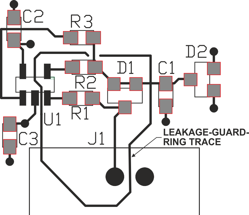

For best performance, place copper traces around the amplifier's high-impedance points to intercept leakage currents.
Figure 3. For best performance, place copper traces around the amplifier’s
When packaging the circuit, pay special attention to the pc board's layout. Imperfections in the board's dielectric properties can provide parasitic-leakage-current paths. Adding copper traces on both sides of the board to form guard rings around the circuit's high-impedance nodes diverts leakage currents (Figure 3).
