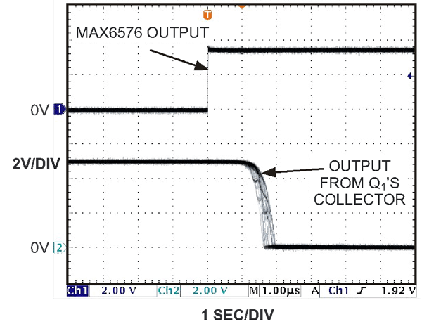

Measured from the positive-going edge of IC2's output to the circuit's output at Q1's collector, the relative jitter averages less than 1 µsec.

In IC1’s sensor output-to-ground return on the data-acquisition system's side, resistor R2 and capacitor C2 shunt Q1’s base-emitter junction. The values of R2 and C2 ensure that the sum of IC2’s current and transformer T1’s magnetizing current cannot drive Q1 into conduction. When Q2 conducts, it draws about 12 mA from the isolated 4.5 V power-supply line. Reflecting to the primary, Q2’s conduction current flows from the 5 V supply into IC1, out through its ground terminals, and partly through R2. The voltage drop across R2 exceeds Q1’s base-emitter voltage threshold and supplies sufficient base current to turn on Q1.

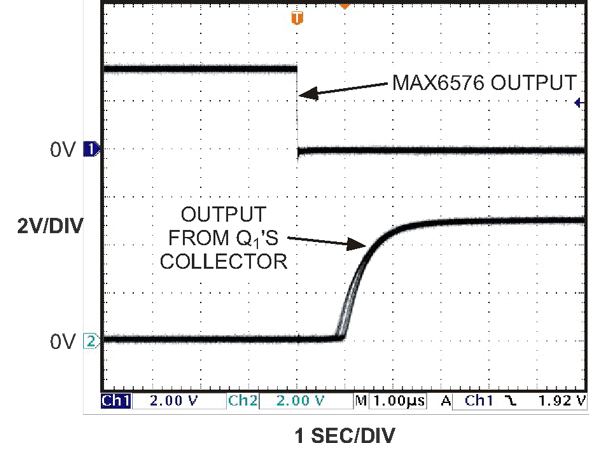

As in Figure 2, Q1's average output jitter with respect to IC1's negative-going output also averages less than 1 µsec.

Thus, when Q2 conducts, so does Q1, which copies IC1’s isolated square-wave output to Q1’s collector circuit. As the waveforms of Figure 2 and Figure 3 show, Q1’s output rise and fall times, jitter, and propagation delay total about 2 µsec. The equivalent measurement error due to timing jitter amounts to less than 0.1 K at the fastest conversion constant of 10 µsec/K. Varying the circuit's supply voltage through a range of 4.5 to 5.5 V introduces an error of less than 0.1 K. The output at Q1’s collector can sink several milliamperes at a voltage excursion of 0 to 5 V.
