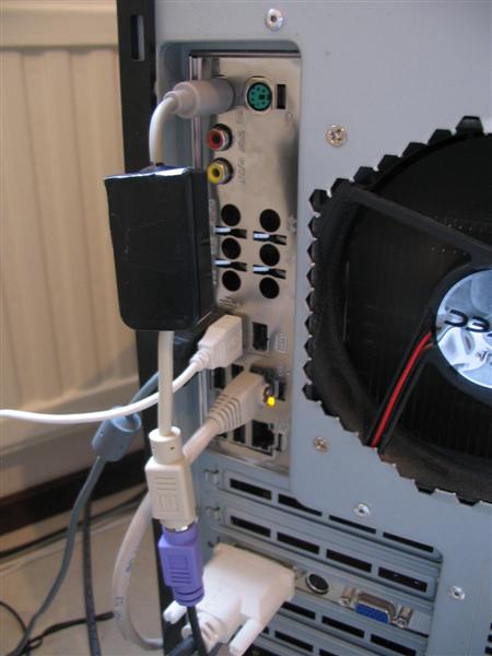

Keylogger with case on it, connected to my PC. It could be much smaller if there was SMD components in it.
