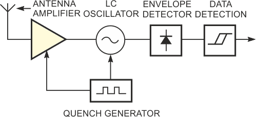

Figure 2 is a block diagram of the super-regenerative receiver circuit in Figure 3. The heart of the receiver comprises an ordinary Colpitts-configured LC oscillator operating at a frequency that the series resonance of L1, L2, C1, C2, and C3 determines. Switching off transistor Q1’s bias current quenches the oscillator. (Note that increasing C1 and C2 improves the oscillator's frequency stability at the expense of increased power consumption.) Cascode-connected transistors Q2 and Q3 form an antenna amplifier that improves the receiver's noise figure and provides some RF isolation between the oscillator and the antenna. To conserve power, the amplifier operates only during oscillation growth.
The super-regenerative receiver is considerably simpler than a superheterodyne circuit.
Figure 2. The super-regenerative receiver is considerably simpler than
Based on a Schmitt-trigger circuit, the quench generator switches the oscillator and RF-amplifier stage. To improve sensitivity, the triangular waveform across C5 quenches the oscillator, and the square wave at the output of IC1 switches the RF amplifier. The quench generator's two outputs are phased in quadrature so that the RF amplifier has received power when the detector's oscillations start to grow. The quench frequency of this circuit is 100 kHz to allow data transfers at rates as high as 20 kbps.
The envelope detector comprises a common-source amplifier that's nominally biased to operate in Class B mode. To increase this stage's gain, you apply a small amount of bias current to make it operate in Class AB mode. To reduce the load on the oscillator's LC tank circuit, C10 connects to a tap on inductor L1, as inductor L2 shows.

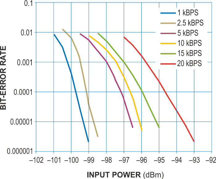

The prototype occupies a compact pc board measuring approximately 5×3 cm (Figure 4). Using a simple, homemade PRBS (pseudorandom-binary-sequence) generator that uses Manchester coding with a 28–1-bit sequence (Reference 2), BER (bit-error-rate) measurements yield the results in Figure 5. These results demonstrate a sensitivity of less than –100 dBm for a 10–4 BER at 1 kbps. The receiver consumes 270 µA at 3 V for a power consumption of 810 µW. As a further enhancement to the design, it includes a transmitter circuit based on Maxim's MAX1472, creating a simple, compact, low-cost, and low-power transceiver for the 433-MHz ISM band. You can easily adapt the receiver circuit for recovery of AM audio or other analog signals by replacing the Schmitt trigger, IC3, with a conventional audio-output amplifier. Retune the RF oscillator to cover the frequency range of interest.
Measurements of bit-error rate versus input RF power highlight the prototype receiver's sensitivity. The frequency is 433.92 MHz.
Figure 5. Measurements of bit-error rate versus input RF power highlight the
