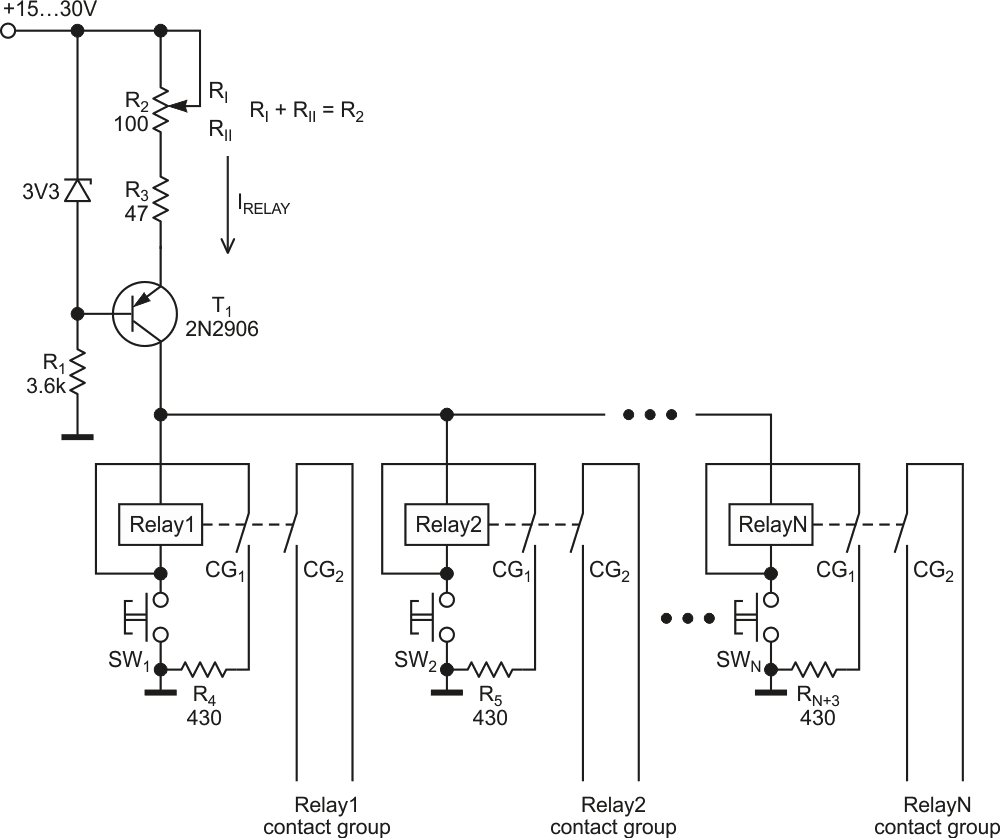

These switches have a fixed and limited number of positions, and you may need more or less. Using the circuit shown in Figure 1, you can make your own one-of-all switch. Contacts CG2 of all relays are used to control the external devices, and CG1 contacts form part of the switching circuitry.
Current source drives 'one-of-all' switch.
Figure 1. Current source drives ’one-of-all’ switch.
An electromagnetic relay activates when coil current exceeds a value called the pull-in current. It deactivates when its current falls below the drop-out current.
A current instead of a voltage source forms the heart of the circuit. It provides current that is equal (or slightly exceeds) the pull-in current of any relay used in the switch.
The Zener diode, resistors R1-R3, and transistor T1 form a current source whose current value IRELAY is determined according to the following equation:

At power-up, all relays are off, and the current source provides no current.
When you press, for example, SW1, Relay1 turns on since its coil is connected directly to the current source. Relay1 contact group CG1 provides self-locking of the relay. When SW1 is released, resistor R4 connects in series with the relay’s coil. But this does not change the value of the current that flows through the relay, since the circuit supply of 15 V-30 V is significantly higher than the relay voltage (5 V).
When, for example, SW2 is pressed, the current provided by the current source now splits in two directions:
  • Relay1 with resistor R4 connected in series
  • Relay2
and is not enough to drive two relays at once. If R4’s value is high enough, current through Relay1 becomes lower than its drop-out value and it switches off. Now, Relay2 is the only circuit for the current from the current source, and it switches on.
