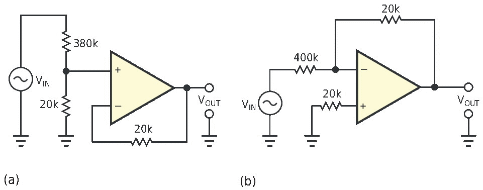

Figure 1 shows two large-signal- measurement methods. The first uses a two-resistor voltage divider and an output buffer, and the second comprises an attenuating inverter and a high-value input resistor. Both of these approaches introduce measurement-linearity errors because only a single resistor dissipates power, which leads to self-heating and its associated change in resistance. In addition, the amplifier and the remaining resistors introduce a combination of offset current, offset voltage, CMRR (common-mode-rejection-ratio) effects, gain error, and drift, which may significantly reduce the system's overall performance.
To measure high voltages, you can use discrete resistors to assemble an input voltage divider and buffer (a) or an attenuating inverter (b), but performance suffers due to thermal mismatch.
Figure 1. To measure high voltages, you can use discrete resistors to assemble an input voltage divider
