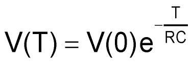

Due to U1c’s gain = R3/R2 + 1 = 2 the current through R1 from VC:
Thus, R1 is made effectively negative which makes R1C negative and for any time T after the 0-1 transition of PWM the familiar exponential decay of:

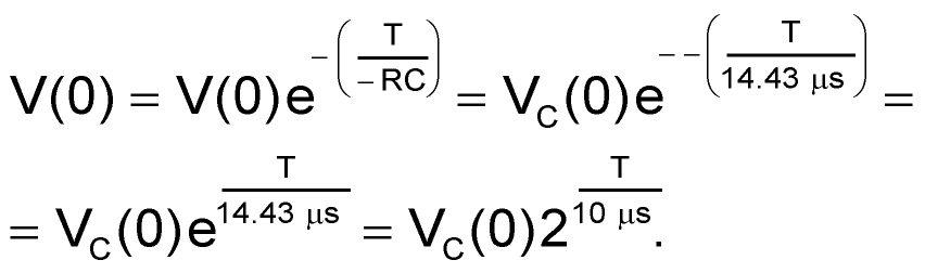

becomes with a negative R1:

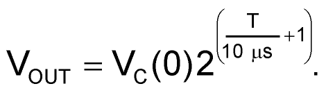

Therefore, taking U1c’s gain of 2.00:

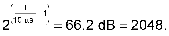

For example, if a 7-bit 1 MHz PWM is used, then each 1 µs increment in the duration of the logic-1 period will equate to a gain increment of 20.1 = 1.072 = 0.60 dB. So, a 100 PWM 1-count would create a gain of
Having 100 available programmable gain settings is a useful and unusual feature.
