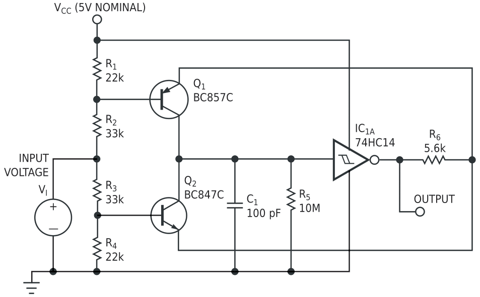

The circuit in Figure 1 is a relatively simple alternative to the triangle/comparator approach. Although the frequency of the output waveform is not stable and varies with input voltage, the circuit is inexpensive, requires only a handful of readily available parts, and exhibits a linear relationship between input voltage and output duty cycle. The circuit lends itself to applications that enclose a simple PWM section within a feedback loop. Also, the excellent dynamics – the duty cycle responds to an input step change within one cycle of the output waveform – make the circuit ideally suited to switch-mode-regulator applications.
In the circuit, the dc input voltage, VI, varies the duty cycle of the rectangular signal at the output of Schmitt inverter, IC1A. Q1 and Q2 function as switched-current sources. These sources charge and discharge timing capacitor C1 at a rate that their base voltages and, hence, the voltage at the junction of R2 and R3 determine. When the output of IC1A is high, C1 charges through R6 and Q1 (Q2 is cut off) with a charge current set by R6 and the emitter voltage of Q1. Similarly, when the output of IC1A is low, C1 discharges via Q2 and R6 (Q1 is cut off) with a discharge current set by R6 and the emitter potential of Q2. Adjusting the input voltage changes the emitter potentials and thus varies the charge and discharge currents so that the duty cycle of the output waveform varies in direct linear proportion to VI.

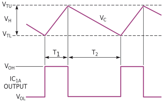

Figure 2 shows the relationship between VC, which is the voltage on C1, and the output waveform. VTU and VTL are the upper and lower thresholds of the Schmitt inverter, VH is the Schmitt trigger's hysteresis, and VOH and VOL are the high and low output levels, respectively, of the inverter.

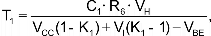

If you assume that VOH = VCC and VOL = 0 V and taking the base-emitter voltages of Q1 and Q2 to be roughly equal and denoted by VBE, you can derive the following first-order expressions for T1 and T2:
and
where
and
Defining the output duty cycle, D, as equal to 100%×T1/(T1 + T2), you can combine the expression for T1 and T2 to yield

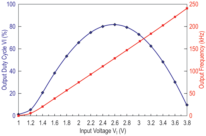

You select C1 and R6 according to the required operating-frequency range. Figure 3 illustrates the results of breadboard tests with R6 = 5.6 kΩ and C1 = 100 pF. The circuit exhibits linear performance with VI at approximately 1.2 to 3.6 V with a corresponding duty-cycle range of approximately 2 to 95%. This figure also shows that the output frequency varies by as much as 15 to 1 over this range; the output frequency peaks when VI is approximately equal to VCC/2.
| Figure 3. | Although the frequency of the output waveform varies with the input voltage, the PWM circuit exhibits a linear relationship between input voltage and output duty cycle. |

The values R1 = R4 = 22 kΩ and R2 = R3 = 33 kΩ meet these requirements and provide an optimum range for VI. These values should provide reliable operation for VCC = 5 V±5% and IC1A and IC1A = 74HC14, but you may need to recalculate the values if you use a different supply voltage or a different inverter.
