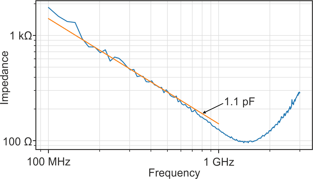

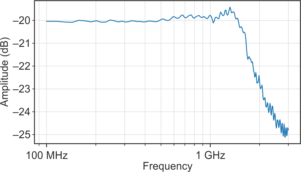

The charts in Figures 4 and 5 show the performance of the rev C probe measured on a network analyzer. The probe shows a very flat response with a 3 dB bandwidth just over 2 GHz. The input impedance is about 1.1 pF, with a ZMIN of about 100 Ω near 1.6 GHz. This is just above my original goal of 1 pF, but is hardly any disappointment.
Probe response VOUT/VSOURCE.
Figure 4. Probe response VOUT/VSOURCE.
Probe input impedance, Z.
Figure 5. Probe input impedance, Z.

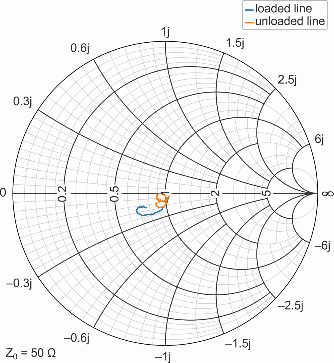

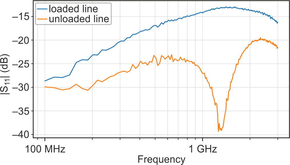

An alternative view of the input impedance is to look at return loss when the probe is used in a 50 Ω environment. Here the return loss of a 50 Ω terminated line is shown in a magnitude (Figure 6) and Smith chart (Figure 7), with and without the probe attached. The return loss of the probed line remains better than 13 dB.
Probe input impedance, S11.
Figure 6. Probe input impedance, S11.
Probe input impedance, S11, in a Smith chart.
Figure 7. Probe input impedance, S11, in a Smith chart.
There is something of an industry schism on how to properly characterize the performance of high-frequency probes. This could be called the what-was vs. what-is controversy (Ref. 4): should a probe seek to accurately reconstruct the signal that was present before the probe was attached (what was), or should it seek to show the signal as it is loaded by the impedance of the probe (what is)? In an ideal world, the probe would have infinite impedance and these two positions would converge. When the probe has finite impedance, then the voltage at the probe input VIN is no longer equal to the source/test generator output VSOURCE. Both interpretations of the probe response as VOUT/VSOURCE or VOUT/VIN are correct, but with different meanings. In the what-was camp are Tektronix and Rohde & Schwartz, while Keysight has advocated for the what-is position. Keysight argues showing the original signal masks loading problems (Ref. 2). Tektronix claims the showing the original signal is more useful, and including the probe loading effect overstates the bandwidth of the probe (Ref. 5). Both claim they’re right and a better fit for real-world probing. For my part, I tend to agree with Tektronix; I want to characterize the DUT, not the combination of the DUT and probe.
Compounding this confusion is the reality that probes are used the field where conditions vary greatly. The nature of the connections from the probe sockets to the DUT greatly impact the parasitics and performance. The probe is usually held in hand, which challenges day-to-day and person-to-person consistency. To get any hope of consistent benchmarking, vendors measure probe performance using a fixture that minimizes variation and parasitics, as have I. In one of its application notes, Keysight freely admits this means “the probe’s specified bandwidth is [typically] unachievable in any everyday, usable configuration” (Ref. 6). Consequently, bandwidth charts for any probe should be considered as a best-case scenario.

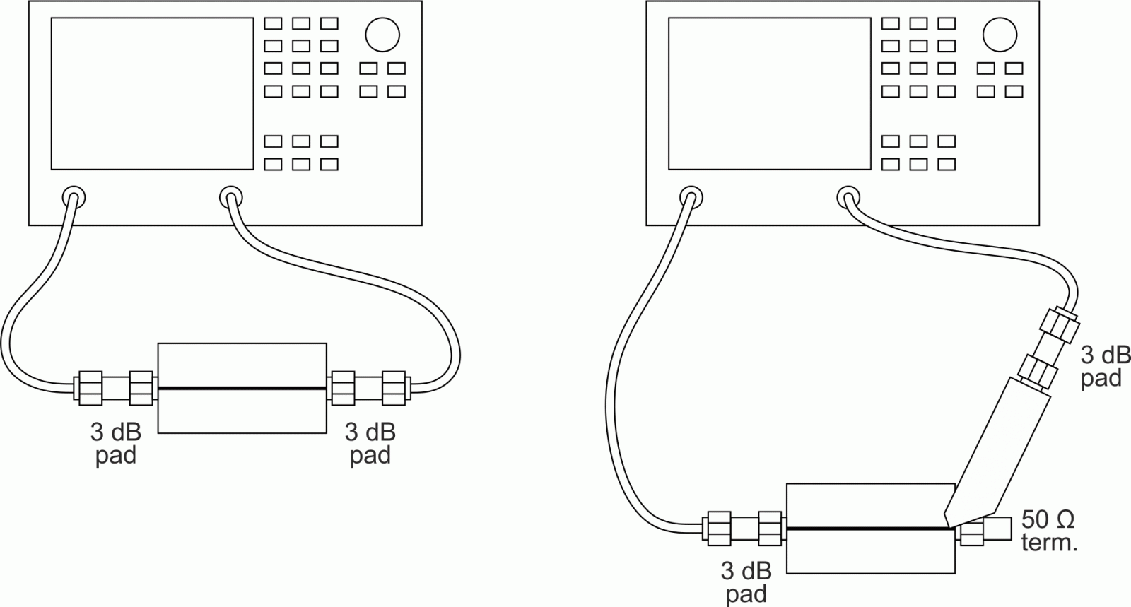

The test fixture in Figure 8 is just a PCB with a 50 Ω exposed thru line and end-launch connectors. Characterizing the probe response is done with a two-port network analyzer. First, a response calibration is made with the analyzer ports connected via the thru fixture, and then the fixture’s port 2 connection is replaced with a termination. The probe output connects to port 2, making the transfer function VOUT/VSOURCE equal to S21. The line should be probed as close to the termination as possible. To reduce ripple from minor mismatches in the measurement path and make for a cleaner chart, inline attenuators are used at the ends of the cables throughout this task.
Two-port calibration and measurement setup for characterizing probe response.
Figure 8. Two-port calibration and measurement setup for characterizing probe response.

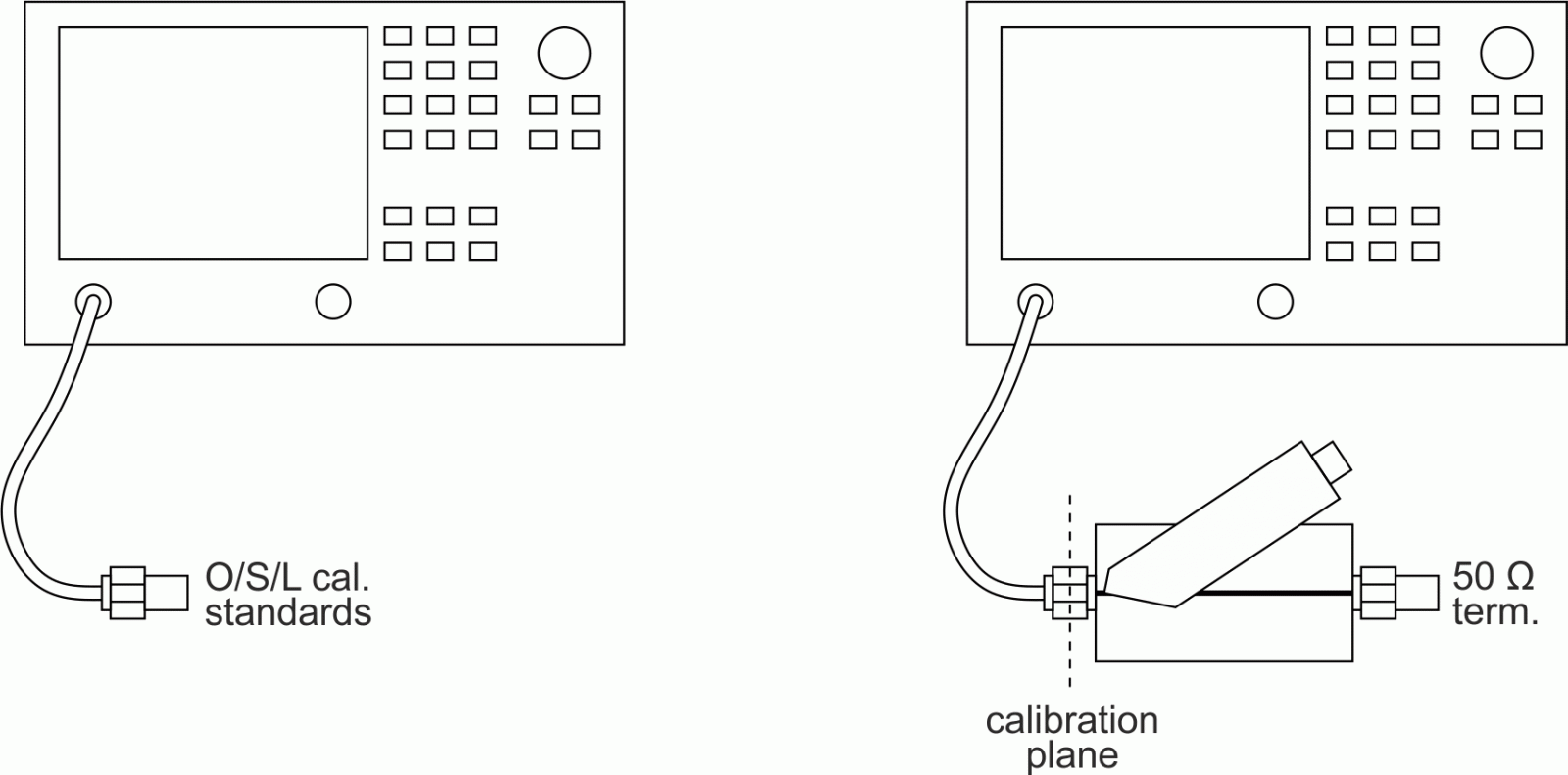

For measuring input impedance, the one-port measurement setup involves performing a calibration and then connecting the terminated thru fixture (Figure 9). The calibration plane is at the connector to the fixture, and the line must be probed as close to this point as possible. To squeeze a little more accuracy out of the calculation, I used the VNA to measure the electrical length from the calibration plane to the board/connector interface, and then added this as a port extension. This adjusts the calibration plane to almost exactly the point of contact with the probe. The return loss is measured with and without the probe connected, and then the probe input impedance can be backed out of these measurements by assuming the probe impedance is in parallel with the impedance of the terminated thru line.
One-port calibration and measurement setup for characterizing input impedance.
Figure 9. One-port calibration and measurement setup for characterizing input impedance.

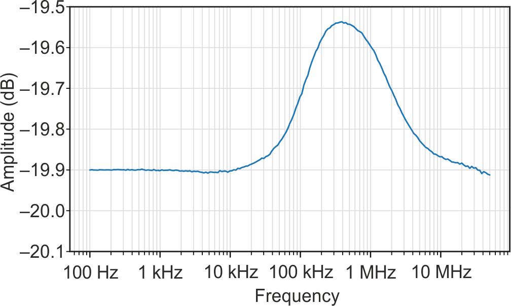

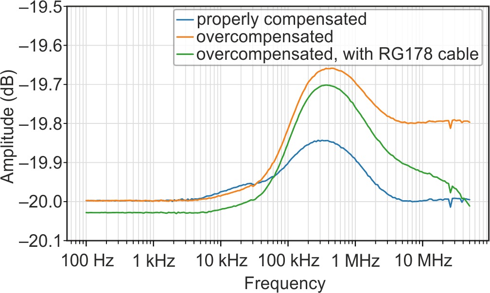

Characterization of the probe in the crossover region started with a mystery and revealed some disappointing limits on the board stackup. In the frequency range of 10 kHz to 10 MHz, the probe output transitions from being driven by feedback from the precision amplifier to following the input resistive divider, and then the capacitive divider. Ideally, the response should be flat. If the input network frequency compensation is imperfect, then one would expect to see flat regions at the low and high end, and a sloping transition between. Instead, I saw the following peaking response (Figures 10 and 11).
Probe response VOUT/VSOURCE, crossover region.
Figure 10. Probe response VOUT/VSOURCE, crossover region.
Evaluation board response VOUT/VSOURCE, crossover region.
Figure 11. Evaluation board response VOUT/VSOURCE, crossover region.
This behavior was puzzling because it didn’t appear in simulation, and also is less prominent with the evaluation board, which has only about 0.1–0.2 dB of peaking in this range when properly compensated. My first hypothesis was the combination of misadjusted frequency compensation and transmission line loss. The evaluation board provided a means to test the hypothesis: the frequency compensation capacitor is a trimmer for easy tuning, and I could interpose a length of poor cable and see if the result matched the chart. When I adjusted the frequency compensation and added a section of RG178 (a thin type of coaxial cable only suitable for short runs), the response demonstrated a similar peaking shape. Given the low frequency, the likely source of the cable loss is from conductor loss rather than dielectric loss.
