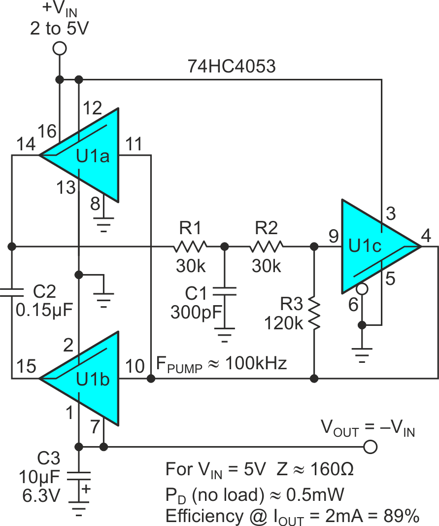

Figure 1 is a cheap and cheerful voltage inverter I offered awhile back in “A simple, accurate, and efficient charge pump voltage inverter for $1” (Ref. 1).
The generic and versatile xx4053 provides the basis for a cheap, efficient, and accurate voltage inverter.
Figure 1. The generic and versatile xx4053 provides the basis for a cheap,
