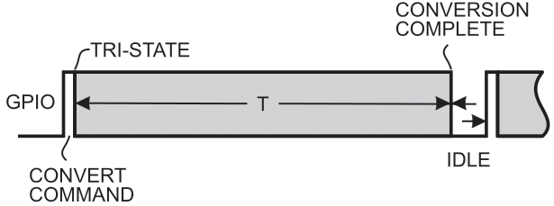

A conversion starts when the I/O pin is programmed for output and pulsed high, overriding U1 pin 3 (OUT) and releasing the reset as sketched in Figure 2. The I/O pin is then immediately tri-stated and reprogrammed as input, gating an internal counter/timer peripheral for measurement of the conversion time T.

Figure 2. A single general-purpose tri-state I/O pin serves to both control and measure
U1’s time-out. The pin is programmed for output and pulsed positive to start
conversion, then tri-stated for timer input. Conversion time (T) is 10 ms for
VIN = 0, decreasing to approximately 100 µs for VIN = 1 kV.
Because U1’s pin 2 (TRG) is held low, the end of reset also sets pin 3 high and releases pin 7, allowing C1 to begin to ramp positive. When it reaches the 2.048 V (Threshold) voltage on pin 5, conversion will complete and the time T that was required to do so is the conversion result. Arrival of pin 5 at the threshold voltage drives pins 3 (Out) low, thereby both pin 4 (RST) and GPIO, the latter being the “conversion complete” status bit to the microprocessor. Meanwhile, pin 7 is driven low to discharge C1. This process completes in about 12 µs, readying the converter for another cycle.
