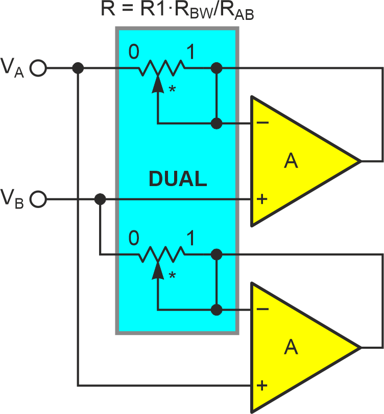

Two-terminal design
And about that single terminal problem. If you have an application that absolutely requires a two-terminal programmable resistance, you might consider Figure 4. Depending on the external circuitry, it might not oscillate.
Duplicate and cross-connect Figure 1's circuitry to get a two-terminal programmable resistance.
Figure 4. Duplicate and cross-connect Figure 1’s circuitry
