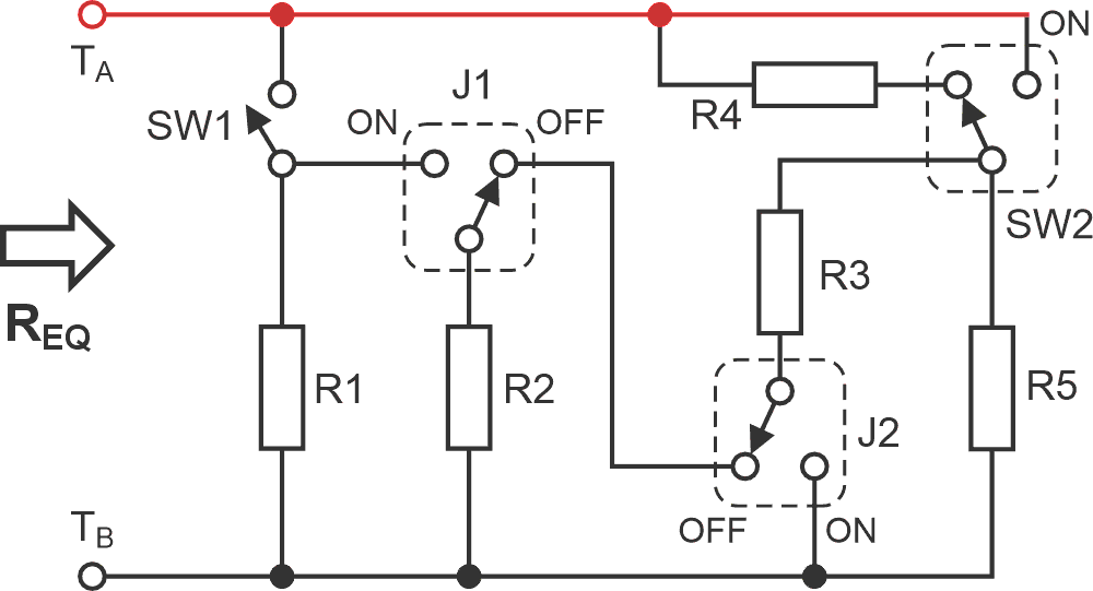

This modular resistor load bank topology, which uses four switches and five resistors, also acts as a building block (Fig. 1). It varies the resistance value in 12 steps; if more than 12 steps are required, another such module can be connected in parallel, thus increasing the number of steps to 144. In this way, it’s possible to get a large number of steps without increasing the complexity.
The load-resistor bank topology with four switches and five resistors is straightforward.
Figure 1. The load-resistor bank topology with four switches and five resistors
is straightforward.
The basic resistor load bank consists of resistors R1 through R5 and switches SW1, J1, J2 and SW2. Switch SW1 is used to control R1 and R2, while switch SW2 is used to control R4 and R5. One end of R2 and R5 is directly connected to ground, while R2 and R3 are connected through jumper switches J1 and J2 to ground. Table 1 shows the equivalent resistance REQ for the various combinations of switch settings.

With four switches, 16 switch-setting combinations are possible. There are 12 distinct values for REQ, using 12 switch settings. (The remaining four switch settings produce repeat values for REQ; these alternate settings are captured in the column labeled “Alt.”) Equations for calculating the value of REQ for 12 distinct combinations are given in the column “Equations,” while the column “Alt Equations” lists equations for alternate combinations.
The division/multiplication factors for 12 switch settings needed to calculate REQ are in the column “Factor.” These factors have been derived when all five resistors are of same value equal to R Ω. The values shown in column “REQ” have been calculated for the case R1 = R2 = R3 = R4 = R5 = 1000 Ω.

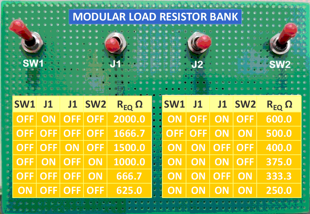

This view of the front panel shows 12 unique resistance values for R = 1000 Ω.
Figure 2. This view of the front panel shows 12 unique resistance values for R = 1000 Ω.
Figure 2 shows the front panel of the load bank, while Figure 3 shows the mounting arrangement of switches and resistors.
Mounting of switches and resistors on the printed wiring board is non-critical.
Figure 3. Mounting of switches and resistors on the printed wiring board is non-critical.

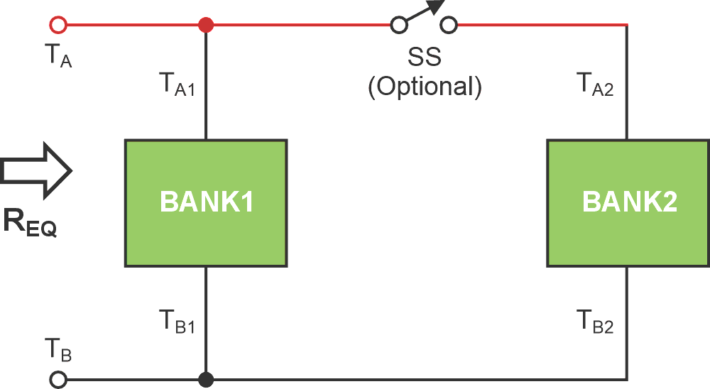

Using the basic load bank module described above, with two modules simply connected in parallel, enables the generation of more steps (Fig. 4). For each setting of resistance for BANK1, we have 12 different settings of BANK2.
The equivalent resistance of load bank is given by:
where REQ1 is the equivalent resistance of BANK1 and REQ2 is the equivalent resistance of BANK2.
There are two ways in which the load banks can be interconnected:
Interconnection with a switch in series
As shown in Figure 4, two load banks are connected through a switch SS. When SS is ON, both banks are connected in parallel. When SS is in the OFF position, only BANK1 is active. Total number of steps generated in this case is determined as follows:
  • When SS is OFF, the number of steps generated using BANK1 = 12.
  •  When SS is ON, the number of steps generated using BANK1 and BANK2 = 12 × 12 = 144.
The parallel connection of two load banks enables an increased number of steps for REQ.
Figure 4. The parallel connection of two load banks enables an increased
Therefore, the total number of steps = 12 + 144 = 156. Thus, by adding one extra switch, we get the benefit of 12 extra steps.

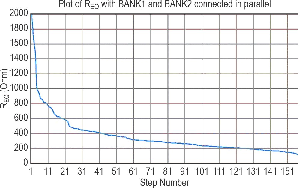

Resistance plot
Figure 5 shows a plot of load bank resistance REQ against the step number (with SS). The step number has been sequenced for getting monotonically decreasing resistance values. If switch SS isn’t used, the 12 values shown in the column “SS OFF” will not be plotted, and there will be only 144 steps.
The variation in REQ with BANK1 (R = 1000 Ω) and BANK2 (R = 910 Ω) resistors (with SS), with the step number sequenced for obtaining monotonically decreasing resistance values.
