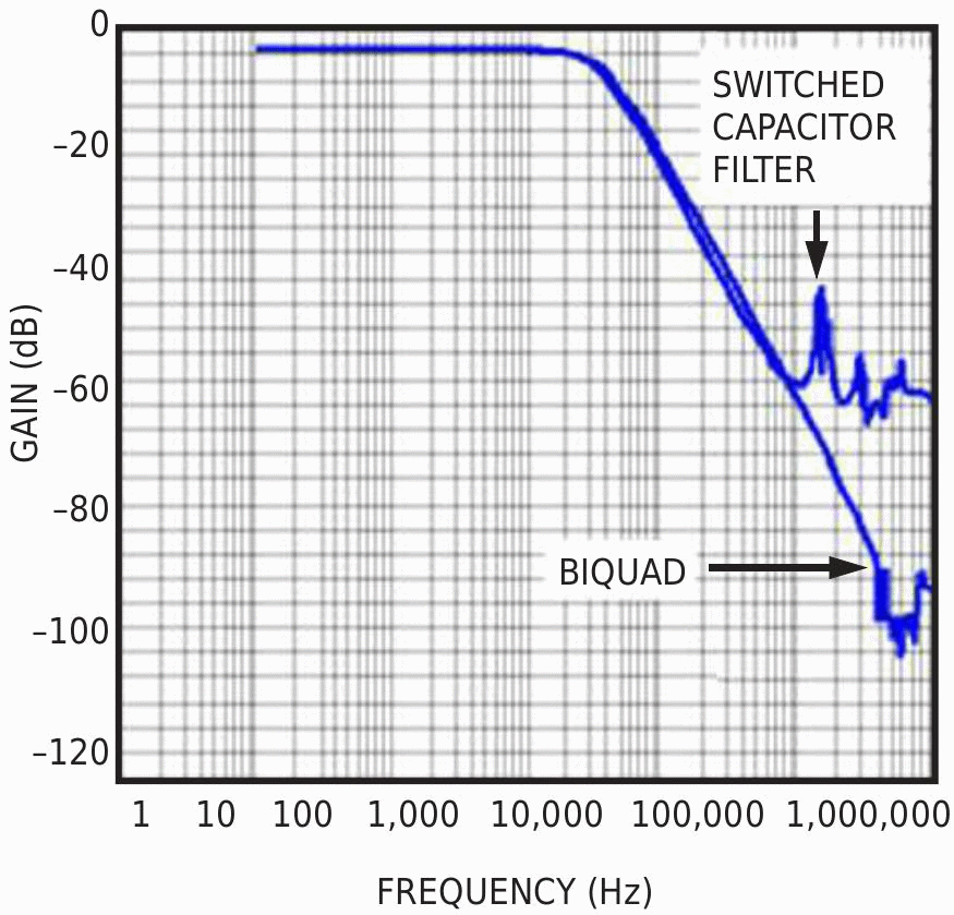

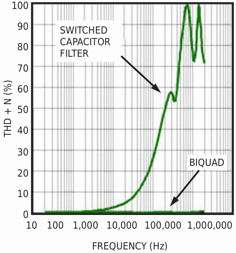

where RIC1, RIC2, and RIC3 are the input resistances of IC1, IC2, and IC3, respectively. The circuit in Figure 1 is substantially more complex than the switched-capacitor approach usually integrated into an IC, but the switching noise and low bandwidth of a switched-capacitor filter are unacceptable in many applications (Figure 2). A biquad filter offers better frequency and noise performance in exchange for more pc-board real estate. And, because monolithic switched-capacitor filters are usually expensive, the biquad circuit of Figure 1 may be a cost-competitive solution. Many filter applications require higher supply voltages, bipolar operation, or both, so the single 5 V supply associated with most switched-capacitor filters may be inadequate for a given application. You can implement ±15 V voltage rails using digital potentiometers and high-voltage op amps, such as the MAX5438 and MAX437.
а) Шумы (а) и низкая полоса пропускания (б) портят характеристики фильтров на коммутируемых конденсаторах. Биквадратный фильтр на Рисунке 1 поддерживает значение THD+N (общие гармонические искажения плюс шум) менее 1% в диапазоне частот от 20 Гц до 200 кГц.
b) Шумы (а) и низкая полоса пропускания (б) портят характеристики фильтров на коммутируемых конденсаторах. Биквадратный фильтр на Рисунке 1 поддерживает значение THD+N (общие гармонические искажения плюс шум) менее 1% в диапазоне частот от 20 Гц до 200 кГц.
Figure 2. Noise (a) and low bandwidth (b) plague switched-capacitor filters.
The biquad filter of Figure 1 maintains less than 1% THD+N over
the range 20 Hz to 200 kHz.

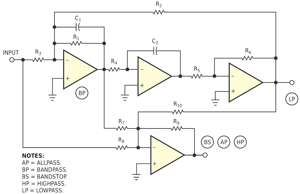

The biquad filter is not limited to the lowpass response. You can implement highpass, bandpass, bandstop, and allpass filters by adding a fourth op amp to selected terminals of the original lowpass design (Figure 3).
The standard biquad filter circuit produces lowpass and bandpass responses, and the addition of a fourth op amp produces a highpass response. Removing R10 and adjusting various component values produce a notch or bandstop response or an allpass response.
Figure 3. The standard biquad filter circuit produces lowpass and bandpass responses, and the addition of a fourth
