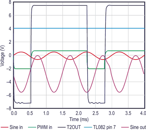

Figure 2. Key waveforms in the circuit are the output from one channel of the sound card (here, a 1-kHz bipolar sine wave); the PWM output, also from the sound card; the amplified PWM signal; the filtered and averaged PWM output; and the sine-wave output, now with negative DC offset.
The 75% duty-cycle PWM input signal is converted to typically ±8 V at T2OUT and, when averaged, produces approximately 4-V DC at pin 7 of U2B (Fig. 2). The 0.5-V sine wave is amplified and offset by the inverting summing amplifier U2A to form the signal-generator’s output.
