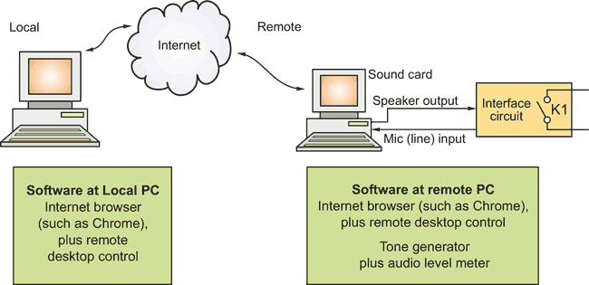

Using a standard PC-sound card and straightforward circuit, you can implement low-cost on/off control of home appliances via the Internet. The system (Fig. 1) consists of a local computer (located where you are) and a remote computer connected to a simple and inexpensive interface circuit with relay output. The local computer needs a browser and an application which offers access to the remote computer over the web, as if you were sitting right in front of it. If you have installed Chrome as your browser, you can add Chrome Remote Desktop. If you use another browser, TeamViewer [1] offers free remote access. This circuit also allows you to check from the local computer if the command is actually being executed.
| Figure 1. | The system configuration shows how the functions connect to enable remote system control via the Internet, based on the use of a standard computer sound card. |
