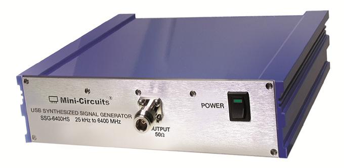

Mini-Circuits released signal generator with Ethernet control, AM, PM, FM, and pulse modulator. The SSG-6400HS is a DDS-based, USB and Ethernet controlled, ultra-wideband signal generator. This high performance model offers:
Mini-Circuits SSG-6400HS
  • Frequency range from 250 kHz to 6400 MHz
  • 85 dB adjustable output power range from -75 dBm to +10 dBm
  • USB and Ethernet control (both HTTP and Telnet communication supported)
  • AM, PM, FM, and pulse modulation
  • Fine frequency resolution (<0.01 Hz)
  • Fine power resolution (0.01 dB)
  • Fast tuning (<300µs)
  • Frequency/power sweeping (up, down, and bi-directional)
  • Hopping over power levels and frequencies
The SSG-6400HS is supplied with our easy-to-install, easy-to-use GUI control software and API objects for Windows environments with complete programming instructions for 32 and 64 bit Windows and Linux operating systems. It is compatible with most third-party software (see list below) allowing easy integration with existing setups.
