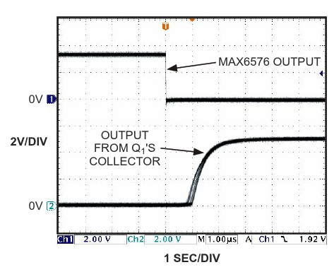

As in Figure 2, Q1's average output jitter with respect to IC1's negative-going output also averages less than 1 µsec

Figure 3. As in Figure 2, Q1's average output jitter with respect to IC1's negative-going output also averages less than 1 µsec
