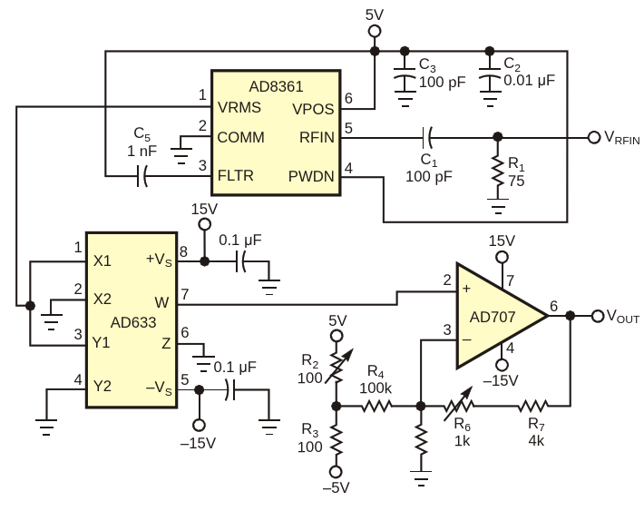

This circuit provides an …
This circuit provides an output voltage that is linearly proportional to the input power in watts
Victor Chang, Eamon Nash - Analog Devices
Make a truly linear RF-power detector
Figure 1
31 Kb
Figure 1. This circuit provides an output voltage that is linearly proportional to the input power in watts
Figure 2. Log amps detect signals over a wide dynamic range, but are not rms-responding
Figure 3. The circuit in Figure 1 responds to rms signals, independent of waveform
