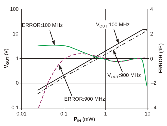

Figure 1. This circuit provides an output voltage that is linearly proportional to the input power in watts
Figure 2. Log amps detect signals over a wide dynamic range, but are not rms-responding
Figure 3. The circuit in Figure 1 responds to rms signals, independent of waveform
