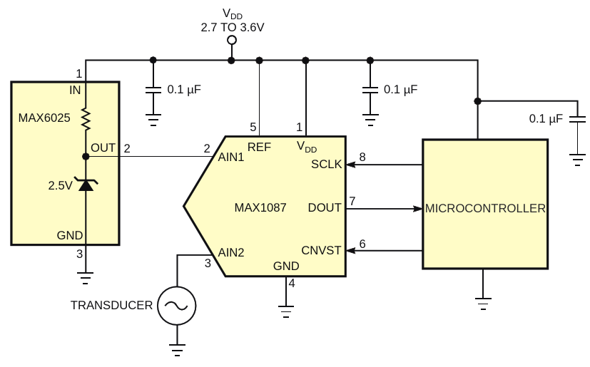

To eliminate the resistive divider, you connect the ADC's reference voltage to its power supply and measure the precision voltage reference's output

Rearranged reference helps ADC measure its own supply voltage

Figure 1. A precision resistive divider brings the power-supply voltage within this ADC's input range but introduces measurement errors
Figure 2. To eliminate the resistive divider, you connect the ADC's reference voltage to its power supply and measure the precision voltage reference's output
