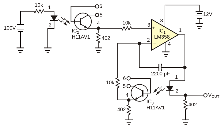

By using two optocouplers …
By using two optocouplers instead of one, you can cancel temperature-dependent gain drift

Circuit compensates optocoupler temperature coefficient
Figure 1
21 Kb
Figure 1. By using two optocouplers instead of one, you can cancel temperature-dependent gain drift
