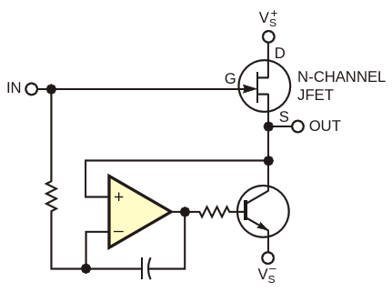

The op amp biases …
The op amp biases the JFET at I
DSS

Op amps make JFET circuits repeatable
Figure 1
15 Kb
Figure 1. The op amp biases the JFET at I
DSS
, with V
GS
= 0 V
