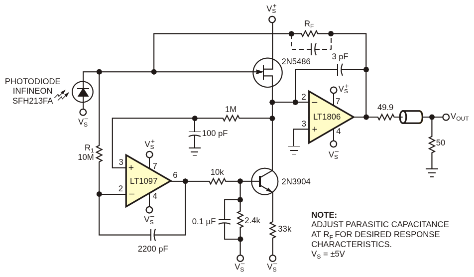

This fast, high-gain photodiode …
This fast, high-gain photodiode amplifier uses Figure 1's scheme to bias the JFET

Op amps make JFET circuits repeatable
Figure 1. The op amp biases the JFET at I
DSS
, with V
GS
= 0 V
Figure 2. This fast, high-gain photodiode amplifier uses Figure 1's scheme to bias the JFET
