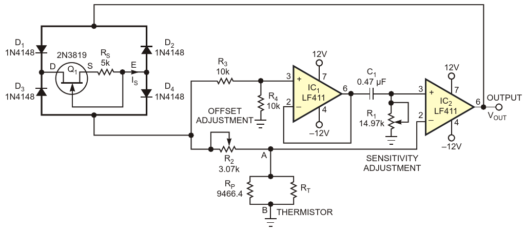

This simple circuit linearizes …
This simple circuit linearizes a thermistor's response and produces an output period that's proportional to temperature
S. Kaliyugavaradan
Temperature-to-period circuit provides linearization of thermistor response
Figure 1
66 Kb
Figure 1. This simple circuit linearizes a thermistor's response and produces an output period that's proportional to temperature
