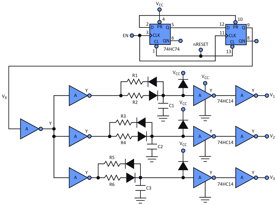

This circuit sequences three …
This circuit sequences three different delays to bias voltages V
1
, V
2
, and V
3
so that an LCD can be powered up and powered down properly

Sequence Generator Delays Bias Voltages To LCDs
Figure 1
40 Kb
Figure 1. This circuit sequences three different delays to bias voltages V
1
, V
2
, and V
3
