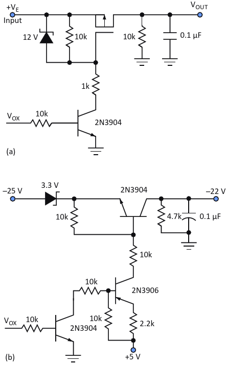

to the LCD through the positive voltage switch (a), while V
3
controls the -22-V bias through the negative control switch (b)

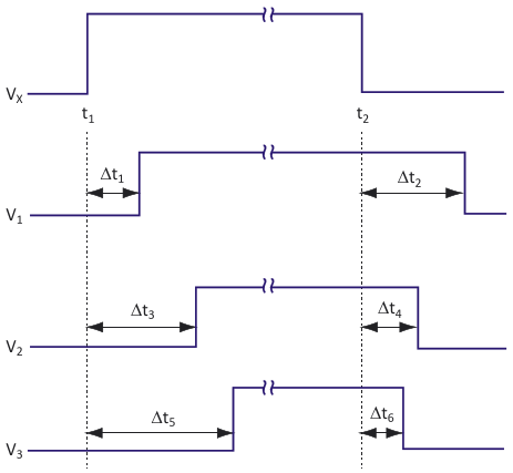

Sequence Generator Delays Bias Voltages To LCDs
Figure 2
29 Kb
Figure 1. This circuit sequences three different delays to bias voltages V
1
, V
2
, and V
3
so that an LCD can be powered up and powered down properly
Figure 2. V
1
controls V
CC
3
