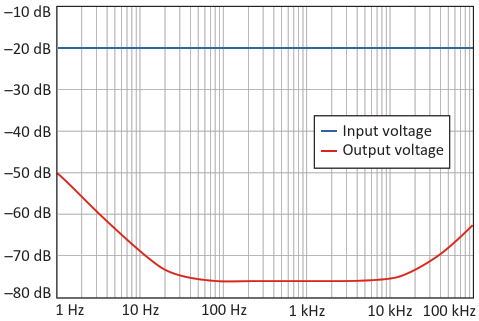

Figure 3. A higher-power ripple-eater augments the simple design with an additional transistor (Q4) to increase gain
Figure 4. The more complex design sacrifices high-frequency performance to provide greater output power
