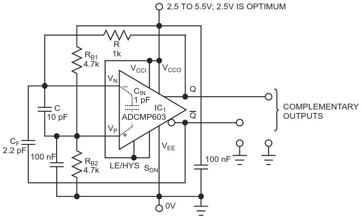

This pulse generator produces …
This pulse generator produces time-aligned complementary logic waveforms. The duty cycle holds at 50%

Pulse Generator with Precision Output-Duty Cycle Operates at a Repetition Rate beyond 50 MHz
Figure 1
78 Kb
Figure 1. This pulse generator produces time-aligned complementary logic waveforms. The duty cycle holds at 50%
