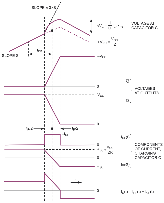

An idealized but still close-to-reality modeling of the operation of the generator gives you a formula for determining the output frequency

Figure 2. An idealized but still close-to-reality modeling of the operation of the generator gives you a formula for determining the output frequency
