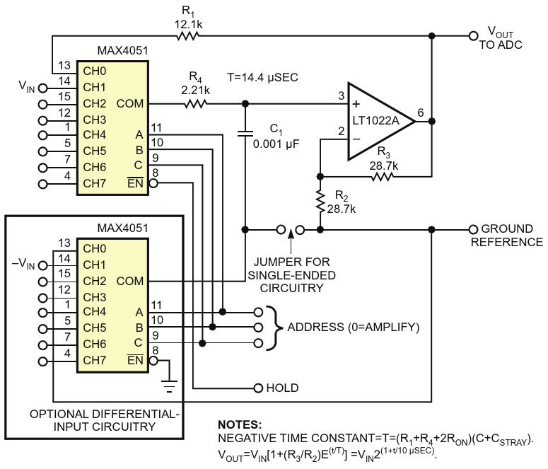

This high-performance, low-parts-count ADC …
This high-performance, low-parts-count ADC front end implements the standard ensemble of functions

Multiplexed, programmable-gain, track-and-hold amplifier has instrumentation inputs
Figure 1. This high-performance, low-parts-count ADC front end implements the standard ensemble of functions
Figure 2. Only the resolution of the amplify interval's timing limits gain-set resolution
Figure 3. This graph of input- and output-voltage gain shows the time elapsed since the track/amplify-logic transition
