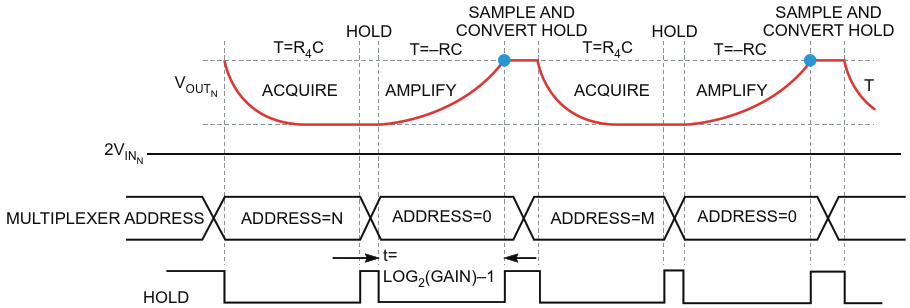

Figure 1. This high-performance, low-parts-count ADC front end implements the standard ensemble of functions
Figure 2. Only the resolution of the amplify interval's timing limits gain-set resolution
