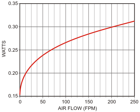

Power dissipated versus air flow of TO-92 held at a constant 31 °C above ambient (P
W
= 31/Z
T
Stephen Woodward
Linearized portable anemometer with thermostated Darlington pair
Figure 1. Power dissipated versus air flow of TO-92 held at a constant 31 °C above ambient (P
W
= 31/Z
T
