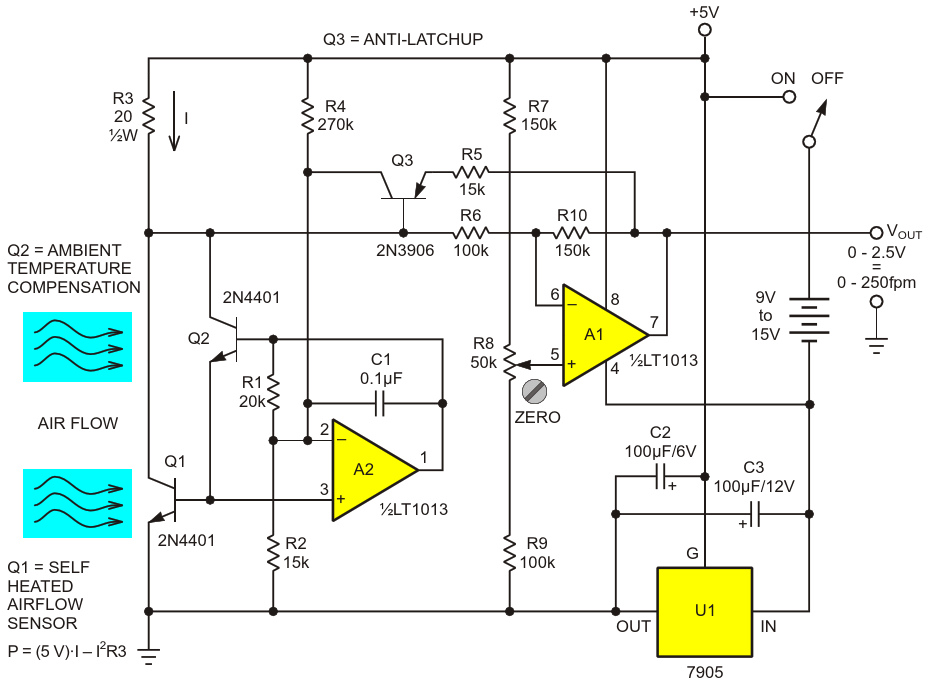

Linearized portable Darlington anemometer …
Linearized portable Darlington anemometer schematic
Stephen Woodward
Linearized portable anemometer with thermostated Darlington pair
Figure 2
29 Kb
Figure 1. Power dissipated versus air flow of TO-92 held at a constant 31 °C above ambient (P
W
= 31/Z
T
Figure 2. Linearized portable Darlington anemometer schematic
Figure 3. Q
1
power versus collector current
Figure 4. Darlington anemometer output versus actual airspeed
