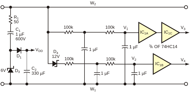

Short DC Power-Line Pulses Afford Remote Control
Figure 1. This circuit creates dc pulses for use with control circuitry located at the load
Figure 2. This control circuit uses dc pulses from the circuit in Figure 1 to drive triacs in the circuit in Figure 3
Figure 3. Triacs independently control two loads based on signals from a pair of wall switches
